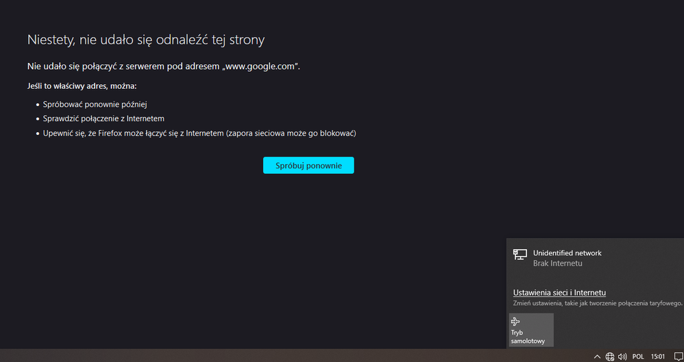

So I've put the virgin hub between the PC and bt Hub and used it as i would with a switch but the network is unindentified and has no internet in that case. my neighbour who ordered bt engineer around the same time did recieve two cables unlike me one for socket and one for pc so i borrowed it off him and results are the same. I also tested cat6 cable i had and the original cable i was using is cat5e. I will play some games to see if disconnects persists and update on that but the vpn is still refusing to work properly. It only works on wifi. I'm starting to think maybe my hub is faulty? It's so wierd for this issue to be so specific when internet off VPN mostly works.
What is interesting is that im getting 0 speed on checking network state and to get speeds shown i need to manually shut down the controller and turn it on again to see packets moving and speed showing.

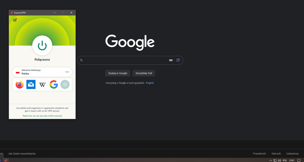

Using ethernet with a virgin hub connected to their box works perfectly fine and the vpn is also working without a hitch. The vpn craps the bed ONLY on bt ethernet connection
