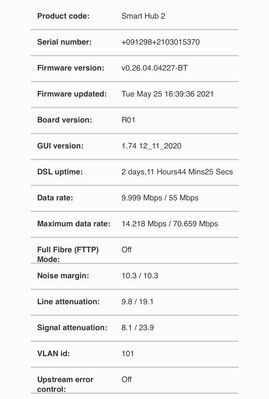

Can you post router stats please?

Here you go.  

Thanks.
When did the order complete? You are definitely still on Fibre 1.

Sorry for the problems with your broadband speed.  I understand that from the outset you intended to go straight on to Fibre 2 but it was only showing Fibre 1 speeds available at that time.  Going by your Hub stats, your line is definitely capable of the Fibre 2 speeds.  I'm sorry that the upgrade hasn't made any change to your speed.
There is no need for an engineer to visit as we can remotely change your speeds to the Fibre 2 product from here.  I have sent you a private message with instructions on how you can send us over your details and we'll look into this for you. See: Private messages
